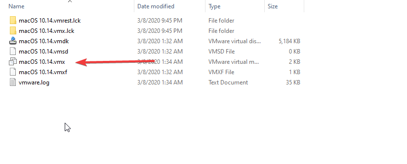

Now, navigate to wherever your virtual machine is saved.
Mine is in Documents, Virtual Machines, Virtual Machine Name

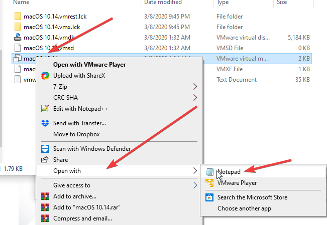

Find the .vmx file
Open with notepad, you may need to open notepad, then click open on this file.
At the bottom add
bios.bootDelay = "2000"
and if you are a RYZEN cpu, add
cpuid.1.eax = "0000:0000:0000:0001:0000:0110:1010:0101"
if you are an AMDFX cpu do nothing.
Alright, save and lets boot her up

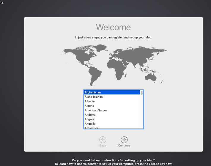

now is this not the nicest thing?
![](upload://8aRKmhi0xvxWLdNqeS2zG5v3EBO.png)[img]https://i.imgur.com/Cw0ocLH.png[/img]
I select regular english, but if you are queensman english or kangaroo english, or whatever, check it here.

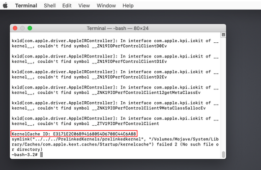

Open the terminal
![](upload://sXj1QghKgnHC7q02Ai1QALrAVUN.png)[img]https://i.imgur.com/k5ShQ5Z.png[/img]
![](upload://pV8eoIwkYQYFyzagR6x7GHzrcv2.png)[img]https://i.imgur.com/xMQE94X.png[/img]
Should look like this... if not, u fucked up fam.
cp -rf /Volumes/MojaveAMD/System/Library/PrelinkedKernels/prelinkedkernel /Volum - Pastebin.com
[Use these two commands, flarium is blocking me from posting them here. Sorry. ]
paste that shit, I guess kuz you dont have internet rip to you tbh. lmao
These are each "one" line, so get crackalackin

If u get an error like cant lead shit on various discs, like so
[img]https://i.imgur.com/yvNga0Z.pngp/img]
then boot up the installer, then boot up the terminal again and paste in
cp -rf /Volumes/MojaveAMD/System/Library/Kernels/kernel /Volumes/Mojave/System/Library/Kernels/
cp -rf /Volumes/MojaveAMD/System/Library/Extensions/System.kext /Volumes/Mojave/System/Library/Extensions/
chmod -R 755 /Volumes/Mojave/System/Library/Extensions/
chown -R root:wheel /Volumes/Mojave/System/Library/Extensions/
rm -rf /Volumes/Mojave/System/Library/PrelinkedKernels/prelinkedkernel
kextcache -u /Volumes/Mojave/
each is one line. I dont think u can paste this, so GL.
Ur looking to have ur kernel rebuilt
close terminal, reboot, and u should get another install screen. lmao rite?
